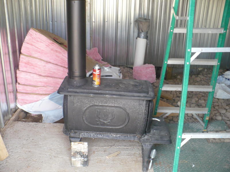

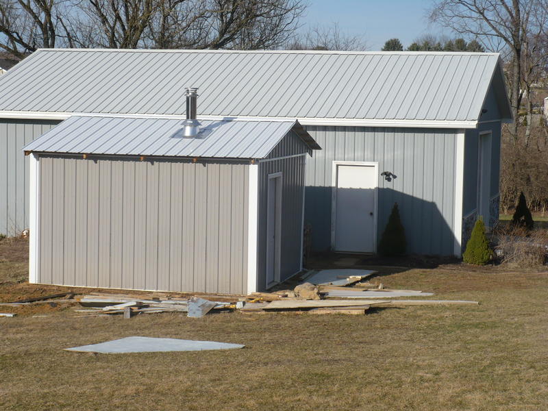

Doc, I put an outside building up for my wood burner. I ran heat and return lines underground the 10 feet to my shop. I'm still getting the bugs out of it as a system, but the main reason I went with a remote stove is insurance. The stove itself wasn't expensive. I paid more for my saws and splitter. I bought a stove rated for 1600 sq. feet to heat a space 1200 sq. ft. It takes up to 26" billets. That being said, a good friend has run outside wood stoves for many years and really likes them. The insulation on his latest one is impressive. He heats water in the summer with 1-2 billets a week. If I were you and had that much woodland, I wouldn't even consider a pellet stove.

Doc, I built a 12X14 shed over what was a thermal collector, which is about 10 feet from the shop. I retained the 2' deep rock bed for residual heat. I'm still working the kinks out of it, but I use it only when I'm working in the shop, usually weekends. I believe I'll burn more wood since the stove is in another building, but not a whole lot. I just use a box fan at the inside end of the heat run to bring the heat into the shop. I have an old cast iron register that I want to mount over the stove and supply hot water to a real good suspended heater I bartered for some welding. I insulated the heck out of the stove building, hopefully not enough to affect air to burn. At the moment, the heat run has some mud in it from construction that I'm trying to work out 'cause it's restricting air flow. As far as insurance goes, I drew up a set of plans for my agent and took them to his office. There was no increase in premiums for having the stove in a building other than the shop. If you're curious, the thermal collector worked for two winters. After that, we never had enough sunny days to get it warm, plus keeping it sealed was a headache. It didn't provide a lot of heat, but it was better than the wrenches stick-freezing to my hands. I tried to attach a few pictures of my set-up, but they won't load.
zionview
My MAC's being a bear, so hopefully some pics got uploaded. I cantilevered the trusses for some weather protection so I can stage wood outside the building, between it and the shop. One pic is from back when I built the thermal collector. Those are the runs I'm still using for heat and return. You can sorta see the rock bed behind the concrete pad the stove is sitting on.

Wow. Very nice set up. That little stove heats your enire workshop? How long does it take it to get up to 65 or so?
Great work. Very impressive. Thanks for sharing!!!!!

To tell the truth, I haven't tried to get it that warm. 45 or 50 is good for me. Right now I'm trying to get that heat run cleared so I can give it a good try out. I think adding the hot water heater will make it a lot more efficient, but the way I'm going, that will be next fall's project.

In my previous house, I used a wall vent propane heater to heat the attached 32'X36' garage. Insurance? No problem. When I approached my agent about heating my present shop(before he saw my drawings), he said "you're not putting a stove inside the shop, are you?" Apparently, it's a touchy subject with my insurer, too. He also told me he couldn't carry me if I built my own stove, no matter how much confidence he had in me personally. Not even with it in another building next to the shop.
