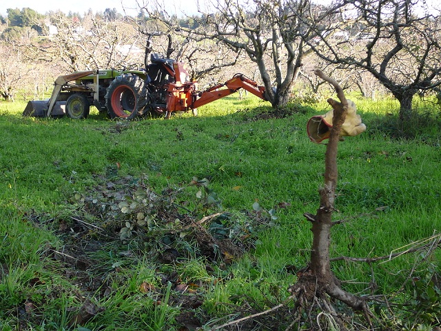

And here's a thread showing it doing some actual farm work this spring. It's perfect for slipping under the trees in the orchard where the YM240 won't fit. (Note the branch in front of the steering wheel).
I kept the YM240 for its 5 ft wide loader and for carrying the backhoe that stays on it most of the time now.
