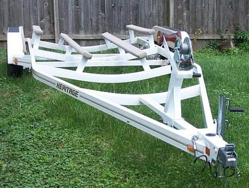

Do you have a picture of that dump insert as well as your existing components so we have a better idea?
I see your location is MA so I'm assuming Massachusetts. If that's the case, have you looked into old boat trailers as your base? That's what we used to use.
They're wide open so if you remove the rails (the elevated ones in the picture below), you can just reach in there and grab them. Option B is to use a series of rollers. when you want to unload, wrap a chain around the logs at the back side of the trailer then either pull them off or tie off that chain and pull the trailer out from under them.
