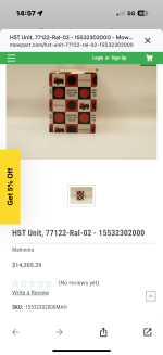

Really?! do you possibly have a link for one that’s 1800? I found the HST on eBay used for 3K. But it’s missing the control assembly that sits on top. But the only new one I can find is this one for 14 K, so I just assume the dealer had a hook up with a discount
