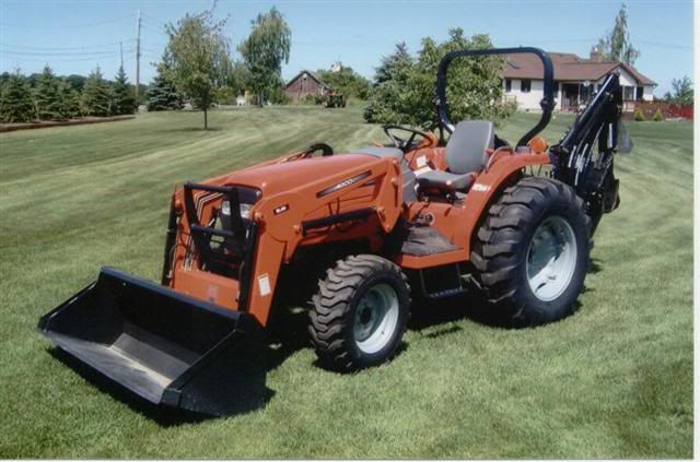

My Brother just bought this one last year and I had the pleasure of digging a 400' drain field with it last September in a word (Impressive in every respect comes to mind)!! It is a MF badged by Agco which also is doing the same for Allis, now under the same umbrella AGCO as well as several others,,,
I really don't thing you can go wrong with any of the AGCO offerings.
