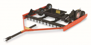

I have one of those I'm wanting to sell. It has a wireless remote and battery on the grader itself.
Pretty sure it's the one pictured below.
It has an electrical issue. When you hit the remote, it doesn't lift or lower. I have the troubleshooting manual (direct from DR) to get it fixed. I haven't bothered (yet) in that I have a 3-point landscape rake on the tractor which is better suited to my needs and terrain.
$350 as is/where is. More if I do the troubleshooting and repair it myself.
Where is this machine? I am in NH and would consider this if not too far away.
Western PA. The closest I get to your location would be Buffalo or Rochester NY which I visit a few times per year.
I did some troubleshooting on it. The hydraulic piston is shot. DR doesn't offer an exact replacement (for the wireless controls) but has a retrofit kit to switch it over to a wired remote setup. Unfortunately, this "kit" is $350.
I started looking for an electric linear actuator as a replacement but kind of lost interest in the project since it's not a grader I'm likely to use again.
I will say that if you're in a hilly area of NH and towing this behind an ATV on something like a gravel drive, going uphill while dragging, the ATV can have a tough time of it.
I also have a York Rake TA-1 that I'm considering selling. Looks like what's in the picture below. It's an older one but in very good condition. If I go back to looking at linear actuators, I was thinking of putting one on this rake.
