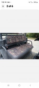

I am working on a custom home made side by side and need to build a bench seat for it. I can get the seat cover for a 2004 to 2010 RTV900 at a good price but need to know what the length and width of the upper and lower seat cushions are to confirm it will fit my project and to build the correct size backing boards to mount the cushions.
If someone who has one of these RTV 900 machines I would appreciate if you can measure the upper and lower cushions for me. (Length and width) Also the dimension between the 2 pipe frames at the ends of the lower seat cushion would be useful.

The cover you pictured looks right for the RTV. Are you going to be able to cut the foam to match the contours of the bottom cushion?
