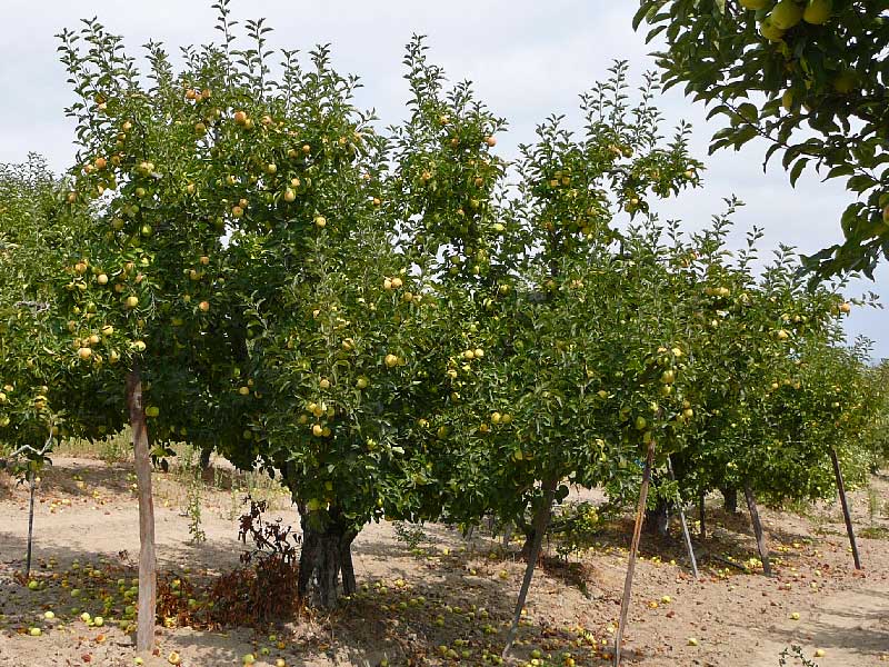

The neighbors who contract to operate my orchard have never had ROPS (because it's an orchard) but they say to load all the weight you can find on a tractor, with all tires loaded plus wheel weights, to prevent a rollover on steep ground. They seem to get normal life out of their tractors. Half their stuff is old gear like several MF 135's which have loader forks front and rear, each carrying a 1600 lb harvest bin.
They used to disc this part every year back when it had some nice apple trees.
I wouldn't even go down there before I added the ROPS!
attachment.php
(Couple more pix in the same area)
Here's the more normal 90% of the orchard.
