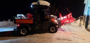

I have a '16 X1120- I need to diff lock to keep my tires from spinning!
Blackwater Evolution Tires
Boss 6'6'' V
HD Shocks up front
400lbs of Ballast to the rear
The thing is a beast and pushed off our 28'' Blizzard this year after I was out all storm working my other job.
Couldn't be happier with this setup. Would have taken me all day with the NH 1725 FEL and walk behind snow thrower.
Try setting the throttle to half or 3/4 and feather the pedal. I only max it and leave it when i really need it.
