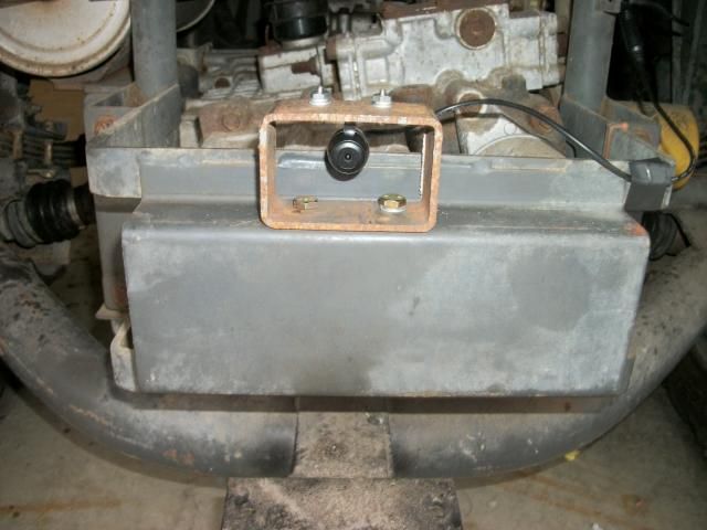

Installed my review camera the other day. It is foggy today and the back window is fogged up. Heater is taking care of the front windshield and eventually take care of the rear and sides. But with the rear view camera I have a real good view of behind the rtv. My system can handle 2 cameras, so I mounted one down low by the rear hitch and then mounted the other one high up by my work light on the rear. Can switch views with monitor.

Mounted here.
