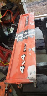

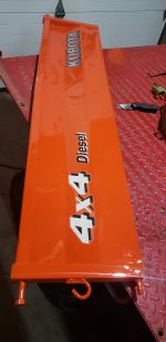

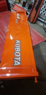

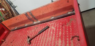

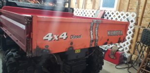

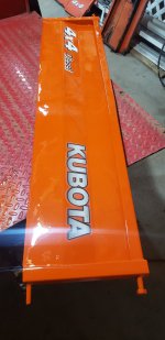

Ok.here are the photos of the tailgate i made.also the photo of the kawasaki mule bed,which bolts right onto the kubota.im using the mule bed ,which had no gate,my kubota bed was junk.but...
The sides were ok.so the sides are 3 inches or a bit more shorter than the gate width. So I cut one side down the center,an then took a 3 inch section from the other side an added it to the center to make the correct width.i believe it was 51 1/2 inches wide,an the bed is 4 feet deep .
I just masked up over the stickers so I didn't have to buy new ones.
The paint an everything is explained on my YouTube video I just posted if any questions please ask.
