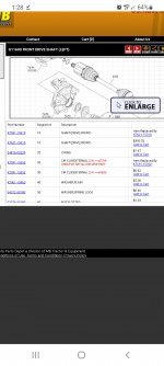

The parts diagram shows a clip that might be holding it in.
Thank you. I saw that clip when I ordered the shaft. I can't see how you would remove that clip. I'm thinking that you just pull/pry the end out of the differential and the clip compresses. Surely you don't have to split the case to change the axle. There are a ton of aftermarket axles out there for these so I'm guessing this is a common failure.
