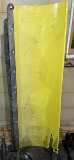

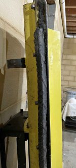

In the referenced link, the discussion includes welding some tubing to the blade so that it doesn't dig into a gravel drive. Because this thread is more recent, rather than asking in that one, I am asking here in hopes of getting better response. I'm getting an 1100C in a few weeks and considering adding a Boss V plow. I can get by with the blade on my JD2305 but really like how well the 1100 with the Boss V gives more flexibility to adjusting the blade. I attach a sacrificial strip of rubber stall mat to the Deere's blade (I drilled holes and bolt it on to the replaceable edge on the plow) so that I can clear snow off of grass for a dog run. It works well without tearing up the grass and also for not churning up my gravel drive. Has anyone heard of anyone doing something like that with the Boss V? If so, any discussion on how well it works?

Mine is a 54" front blade. As you can see, the rubber mat does take a beating. This year it took some extra because I used the plow to move some limestone around in the Spring. I have no experience with using it on pavement except when I'm at the drive to road transition at the end of the drive so no idea how well it would really work. I do run it on my back porch sometimes which is concrete and at ground level. It does ok there but that never gets really deep and it's only about 10 feet wide, 54 feet long and usually only covered about 2 feet along the edge at the most.
