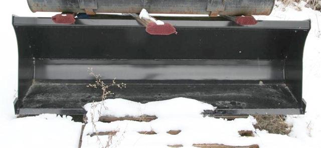

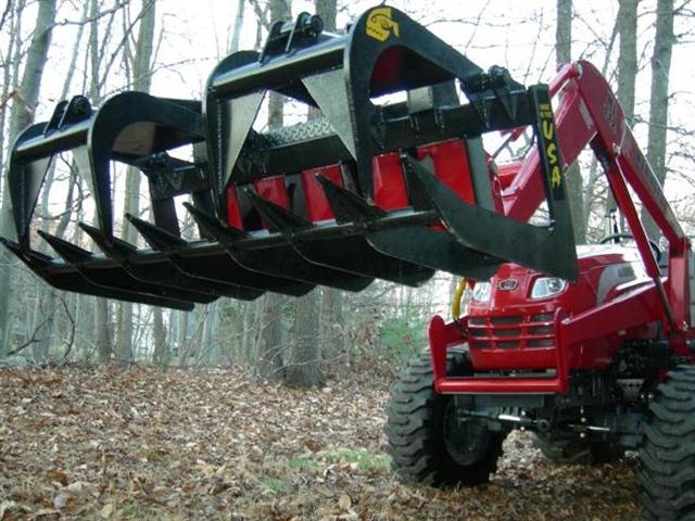

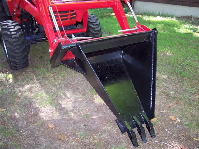

Hey Mud - Everything but the original KMW/Mahindra 72" light-duty FEL bucket already came in black... so all I've done is touch-up the paint and/or powdercoat on them as needed. I'm holding off on repainting the red bucket until some reinforcements are welded onto the top and bottom... but ultimately, it will be sandblasted clean, prime-coated and painted black. :)

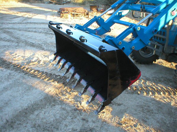

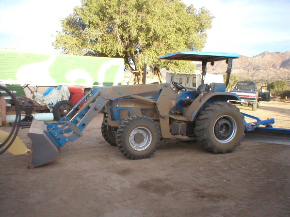

Mud, here's a pic of a red bucket painted blue, then beefed up sandblasted to remove blue paint and then painted black. the red powder coat does not come off with normal sand blasting. I also have one bucket painted Mahindra frame gray.:thumb:

Hee hee hee. I KNOW your right about the paint not coming off with sandblasting. The people that used to blast for us when we needed stuff cleaned up or repainted won't let us bring them any powder coated stuff anymore. It's tough stuff. I got a pretty good chuckle the first time I saw that blue loader with the red showing through on the bucket...
Oops... just went back and read all of Doug's post... yeah... sandblasting... u can try it, but someone is gonna lose. If they bid to you ahead of time not knowing it is powder coat, then the blaster people loose... otherwise they may charge you out yer waazzoooo to blast it.

Hey Jeremy - I'll be doing the sandblasting myself... and a quick test run last fall showed that the powdercoat could be removed... albeit with a lot of work, material and a resulting roughened surface of the bucket. I stopped further work until the reinforcement steel could all be added... but once again, you are the expert here and I trust your judgement! If you tell me not to sandblast and to simply paint over the powdercoat, I shall do so! :)

When you or someone else welds the bucket stiffers on, have your paint ready to spray on the hot/warm metal so the paint can bake on.;)
