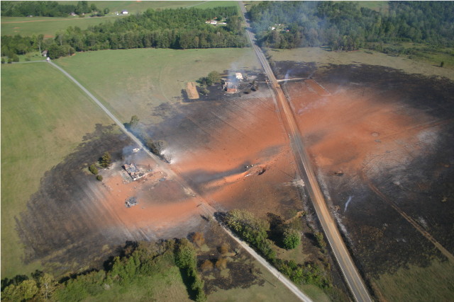

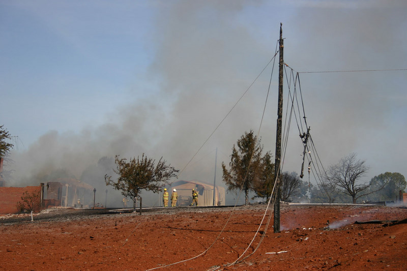

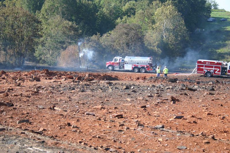

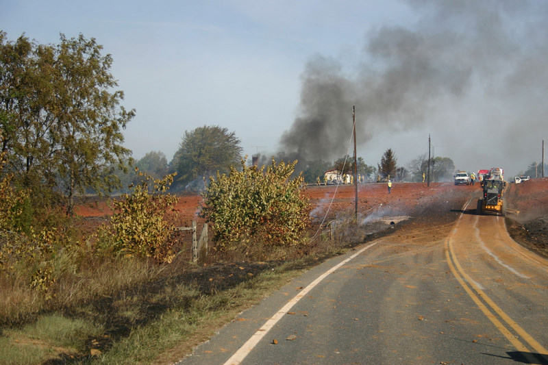

Be careful with gas
Gas line explosion...:(
