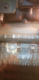

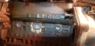

Already filed,an I definitely talked to my attorney prior,I wasn't about to waste the filing fee money if I had no chance. There are so many laws protecting buyers from private sales that nobody even uses if necessary. Its the first time for me.an its a sure win on my end, for a few reasons,but I'm not going to get into it all here i never said anything was based on a verbal agreement either.,but mis-reoresenting a vehicle in itself is a big one. Stated,an sold as a 2011 when vehicle was a 2004.a buy is not expected or responsible to check on certain things,that being one of them...there are so many fair trade act laws its crazy.and my case as I was already told was simple just due to the year as I said,not to mention im only asking for a small amount of money returned to me.i could very well an will have the chance to get a full refund,which I'm not looking for at moment.its just too bad there are just lowlife people just out to take someone's money.
My money wasn't "poorly spent" it was spent to purchase a said 2011 rtv in a certain condition. Neither were true.
