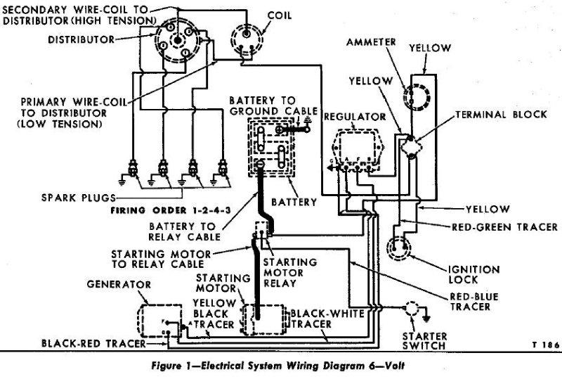

Now my real reason for joining. Can anyone tell me how to wire the starter, battery and switch? I still have it on my trailer and was going to charge the battery and when I hooked it up my charger pegged out. I have charged a lot of batteries over the years and never had that happen. I remembered MY first job after getting out of the navy and it was a garage and I recalled back then (1963) that Ford always used a positive ground. So I checked my manual and sure enough it said positive ground. So I wondered what else was wired wrong. Sooo if anyone can help me I would greatly appreciate it. The manual does not have a wiring diagram.

Welcome to Net Tractor Talk Tommie. Yep, sounds like you figured out the positive ground issue. Surprises me that they were still doing that in 63. I had an 8N that was originally a 6 volt system. By the time I got it someone had done a half assed conversion to 12 volt. Everything turned into electrical problems. Otherwise I loved that tractor.
I saw some wiring diagrams for Ford with positive ground. Now I just have to find them again. :hide: I'll dig em out and post them here for you.
In the mean time, enjoy and post often.

wiring diagram

Now I am on my third cup and have printed you diagram. I went out to the tractor to check but it started to rain. But in So. Cal. it won't last long. I will atempt it again later.

Tommy, If you just want to get it running OK. If you want it for the long haul go ahead and convert it to 12V neg ground now and save yourself a lot of head aches in the future. It's not really hard and most shops have a conversion kit with a alternator and the brackets. You will just need to do a little re-wiring and change the head light bulbs. Your starter will work fine on 12V and you can install a ballast resister for the ignition. You can also get an electronic ignition after the conversion. (Petronics) is the one I have. I have a 1946 2N that has been converted to 12V, Neg ground, electronic ignition and electronic tach. It took a little work, but it starts everytime.

Also Tommy when you convert, normally you will use a 1 wire Delco alternator that has an internal regulator so you won't need the old mechanical regulator any more. (those things are a constant problem

Hello guy's, I'm back. The weather was bad today so I went back to the trailer/tractorand studied the wiring. by the time I would get back to the garage. (That where I live. Grama got a new house . Grampa got a new garage with a bathroom, phones and a desk.) So I finaly made a drawing and discovered it is a one wire setup from the alt. All those wires and find it is just one! How dumb can I be? So I took the battery out of the Chevelle.(It fits better than the long one that was there.) I tried it and got one click from the starter by jumping to the battery then lots of sparks. Maybe I should have sign as stupid and not Tommie. Is there any thing I should know before I go any farther? I bought this thinking how hard can it be its just a four cylinder motor with a honkin set of gears.

Nothing stupid about it. Countless threads have been about Ford Tractors, new owners, and the frustrations of redoing the electrical.
I'm thinking that with a one wire alternator, someone has already done (or attempted) the 12V conversion. The sparks (obviously) indicate either bad or loose connections and/or a dead short.

Tommy, if it has the original 6V starter, and it probably does. Don't overwork the starter. It will last many years on 12V but if you grind it to long it will overheat. Try to get some pic's of the wiring and we will try to walk you thru it. It's not hard and most of the original wiring can be scrapped.
1.) you need a wire #12 to the ignition switch from the battery(+)
2.) you need a wire #12 from the ignition sw (on) to the coil.
3.) you need a wire #12 from the ignition sw (start) to the solenoid.
4.) you need another wire #12 from the ignition sw (on) to the alt.
That will make it run.
The other wires are for lights etc.
If you have a 1 wire alt it may not stop. You may need a diode or small light in the wire from the alt to the switch.
Pic's and we can wire it for you.
Tonny, I forgot to mention, if your tractor has an amp meter, take it out and buy a volt meter to replace it. The older machines actually measured the current leaving the generator going to the battery. These days they just measure the voltage at the battery. Hince all the new cars just have a meter showing 12V 14V etc. If you get the new meter hook one side to ground, and the other side to the (on) pos on the ignition switch. Take all the larger wires from the original amp meter and throw them away.
