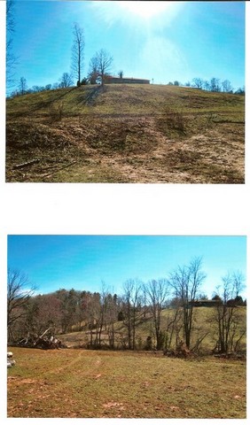

good luck, get some pictures of the land so folks have a better idea of what they're offering advice on, and we'll look forward to many posts in the future!
bobrady, as others have said a picture or two from different angles would help us with helping you, most of us can post any type of pic if you can send it to us in any form by e-mail! And I would be happy to do that!
I work a fairly steep slope at my lake front and there are some really safe options available, perhaps you just need to feel comfortable in doing that and then we can go from there!

Slope pictures posted for bobrady
It really doesn't look that bad so far and top part seems best suited to a good heavy rider with a center deck the lower part looks like any cut would work with a bush hog!
Here are your pictures and hope others have some ideas for you!
