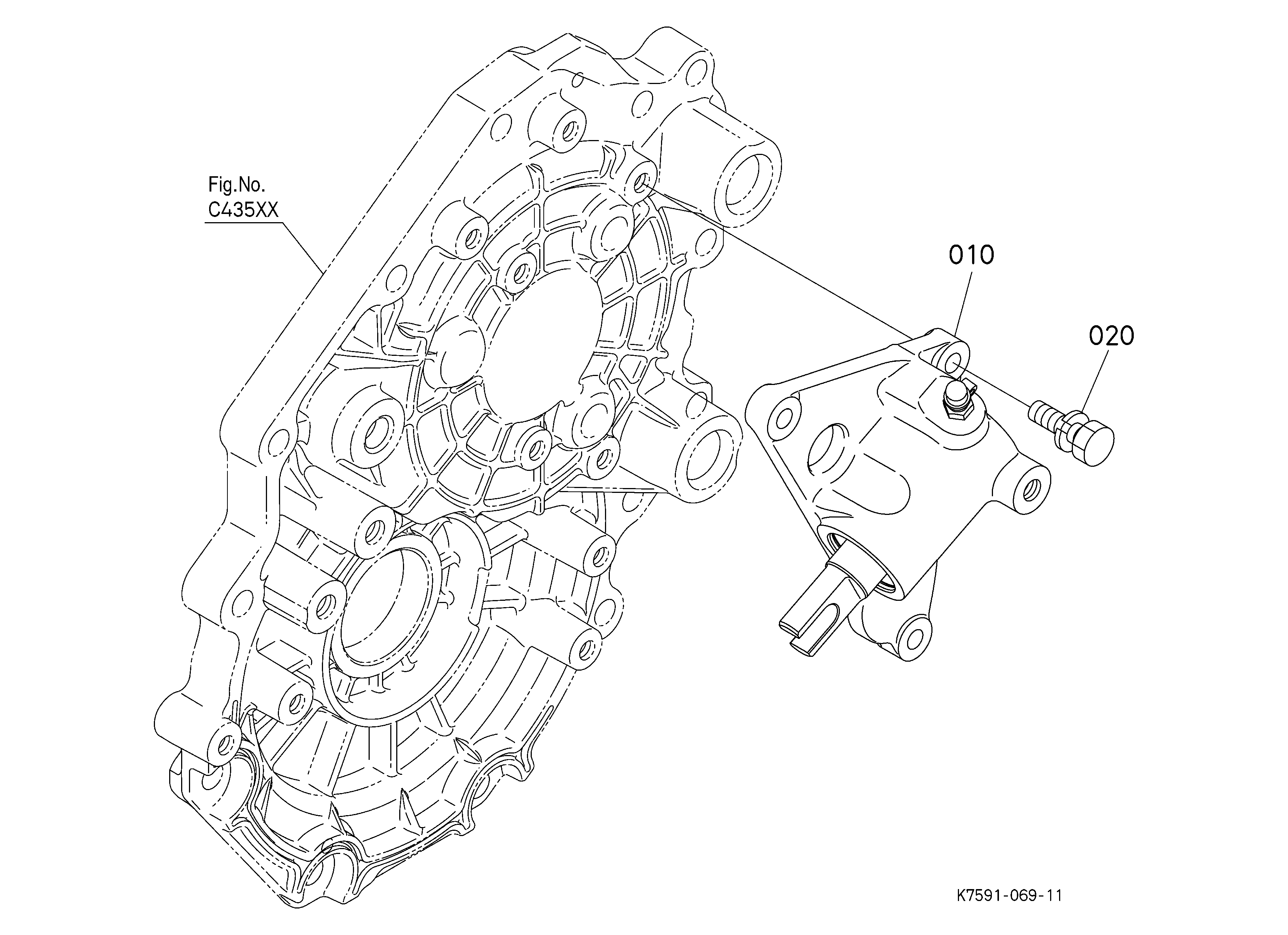

pulled the magnetic plug from the transmission. Plug was covered in metal shavings and had a ball bearing attached to it.
(see attached photos) the fluid also had a silvery streak of fine metal on the top of it in my catch pan.

aurthuritis
the ball bearing came out of the gear case???? or the tank??? yellow colored oil is most likely brass from the valve plates. ball bearing could be from the swash plate bearing but it wouldn't be on the gear case drain plug. what happened to recently serviced? sorry not pointing a finger at you! if the gear case isn't trashed the HST is pretty simple rebuild. i have read of others getting a reman transaxle unit and swap out. very sorry about your troubles.
