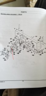

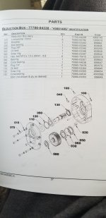

When I shut the machine down last night I noticed that the reduction box was very hot. Once it cool down I checked the oil it was fine. I know pretty much about gearboxes but not so much of a reduction boxes. I do not see anywhere in the drawing that would cause this to heat up. Anybody have any ideas?

I do not own an infrared thermometer if you think it will help troubleshoot I will go buy one. On the parts drawing I have a red line drawn where I touch the casing and after a Few seconds I have to pull my hand away. And that is right where the cone bearing sets. I read an article if you do not have the cone bearing adjusted properly it will cause pressure to the ball bearings which will create friction. If I would have done better planning I could have just taken it to the dealership but I cannot get my trailer out of the snow. If I just do my driveway which is about 600 foot the area is just warm. But when I do all my Trails, my Access Road that's when it starts getting hot. I would not have even noticed it if it weren't for no snow on reduction box that's when I felt the Heat. I am thinking after the snow blower breaks in a little bit the heat may dissipate it only has about 6 hours on the snowblower. They call for high pressure Lube in a reduction box so it must be getting some type of pressure in there. I don't understand how there could be friction build up one side of the reduction box is connected by the K connect with a Lovejoy type of coupling and the snow blades are driven by a worm gear. All I can think of is all the heavy wet snow we had this year together with a 66 inch snow blower that could be the friction problem right there. Thanks for the help!
