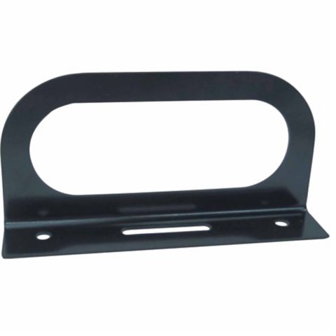

if and when i replace mine im going to the sealed lights like i have on my boat and front flashers on my rtv.Buy brackets and mount them and the new lights slup in and out of a rubber gromet.
http://www.ebay.com/itm/2X-NEW-6-LED-RED-OVAL-SEALED-TURN-SIGNAL-STOP-TAIL-LIGHT-TRUCK-TRAILER-RV-KIT-/191194466041 you can get them cheaper at an auto parts store lights are about 6 bucks a piece and the brackets are about 5 a piece.They also make box brackets too.Its all I use on trailers any more and on the RTV. When it burns out which they rarely do you pop it out of the gromet and replace the whole light and lens and its water tight
