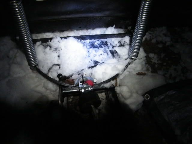

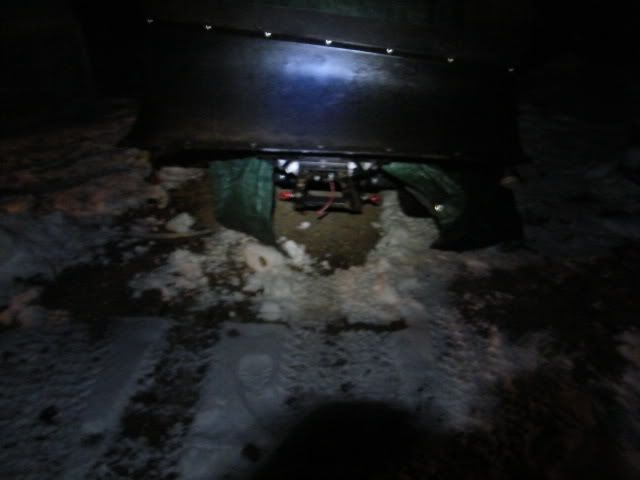

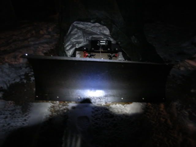

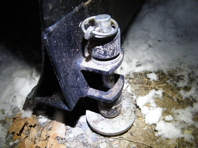

I figured I'd give a little follow up on the American Eagle plow I bought for my RTV 500. I put it on today, it was quick and easy to install. 4 bolts on the front of the RTV 500 where your winch roller fairlead bolts up and you drill 4 bolts underneath the buggy to put the additional 4- 3/8" bolts to keep from tipping the mount. It looks pretty rugged, the only downside I see it that there are 4 ears that hang below the mount....they are still above the lowest point on the buggy so I don't see it as a big deal breaker for me. On to the blade and tube frame...I ordered the country style blade that rolls and throws the snow out, looks good and is well built. The tube frame is also very durable and angling is easy, you push in on a lever, rotate the blade where you want it angled and let go, the pin snaps in and locks it down. So in conclusion I think they are a pretty good value, at a price of about $600 shipped it can't be beat. Now all I have to say is
