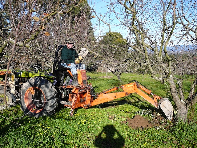

I have a 'Kubota' BH from 1980 that was sold as 'OEM' by both Kubota and Yanmar back then. In the 12 years I've owned it it's just had the routine maintenance you would expect on something now 40 years old. I've replaced a couple of cylinder seals and two hoses, no other problems.
Photo - grubbing out blackberry bushes in the orchard that were so close to trees that the disc didn't get them. Mostly I use it to remove stumps before re-planting Photo2, and trenching.
