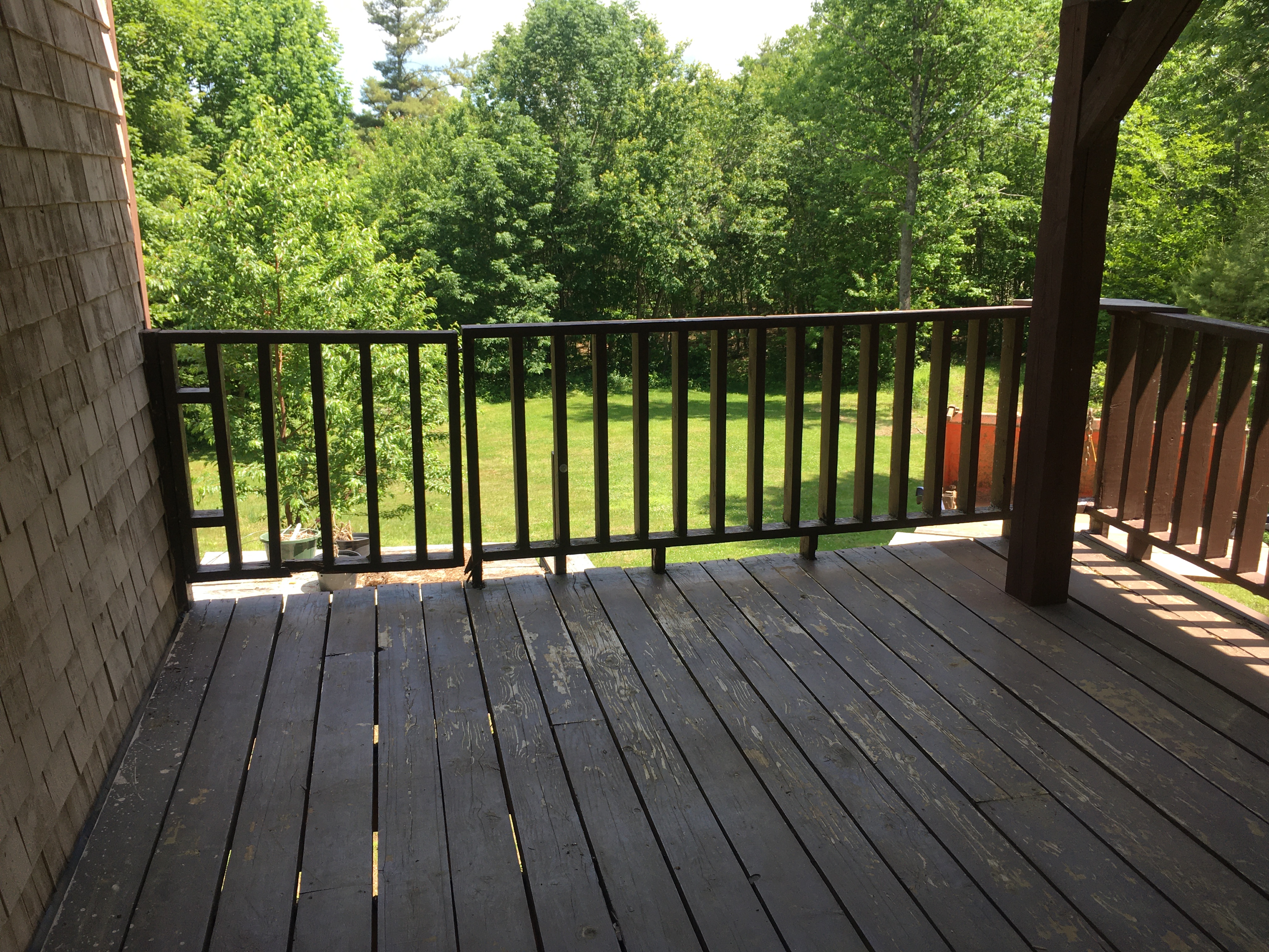

Home improvmet, yuck but it has to be done and I'm the only person I can afford. I now have the lumber, I have the screws, nails, staples, paint brush and HD stain, still looking for the ambition or at least the want-to......
First step is have two sections of railings ready to go after I replace some planking and this is the start and how I'm going to make them........

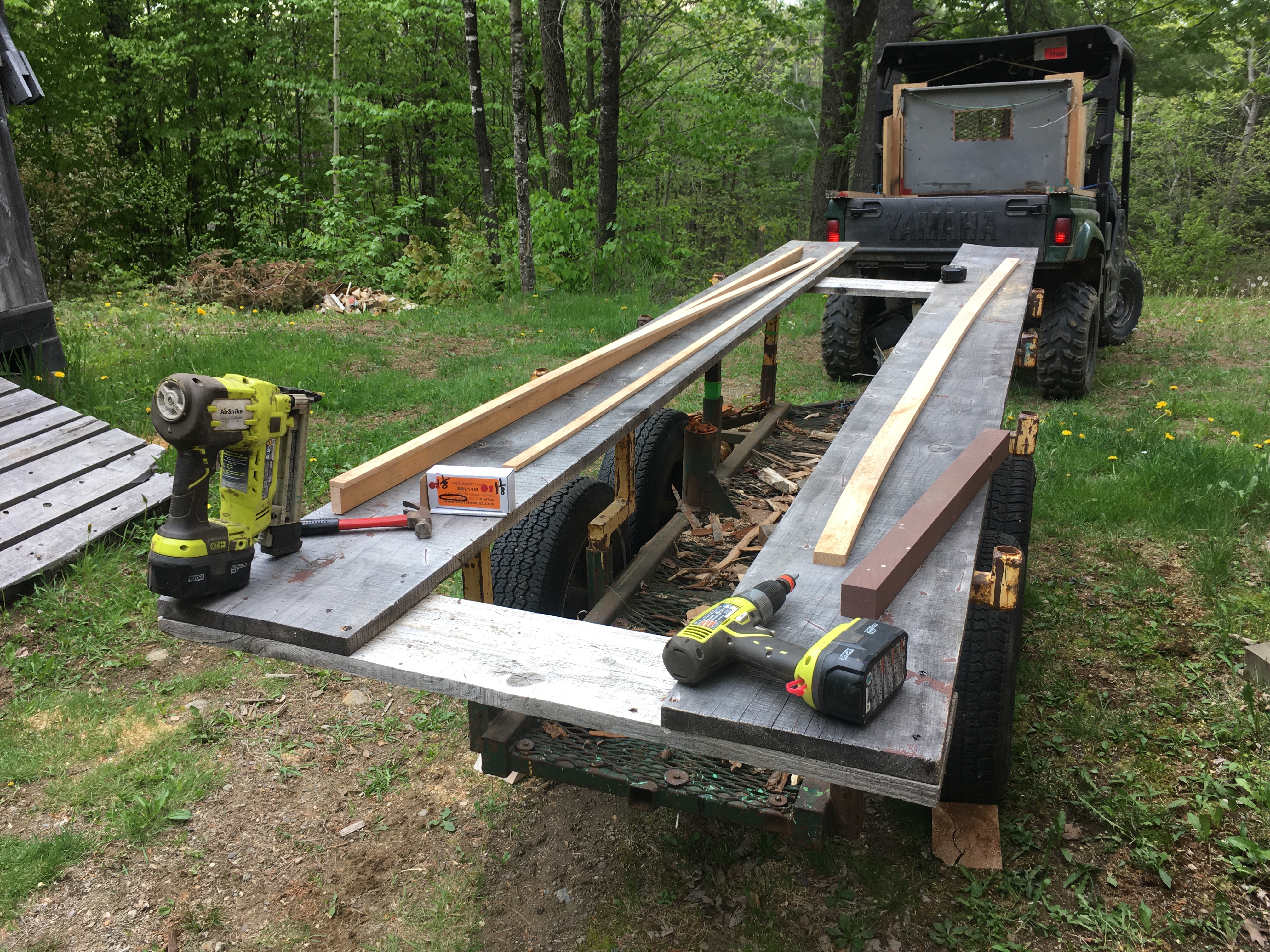

The first part is all in place and ready to screw and nail, next weekend-ish...

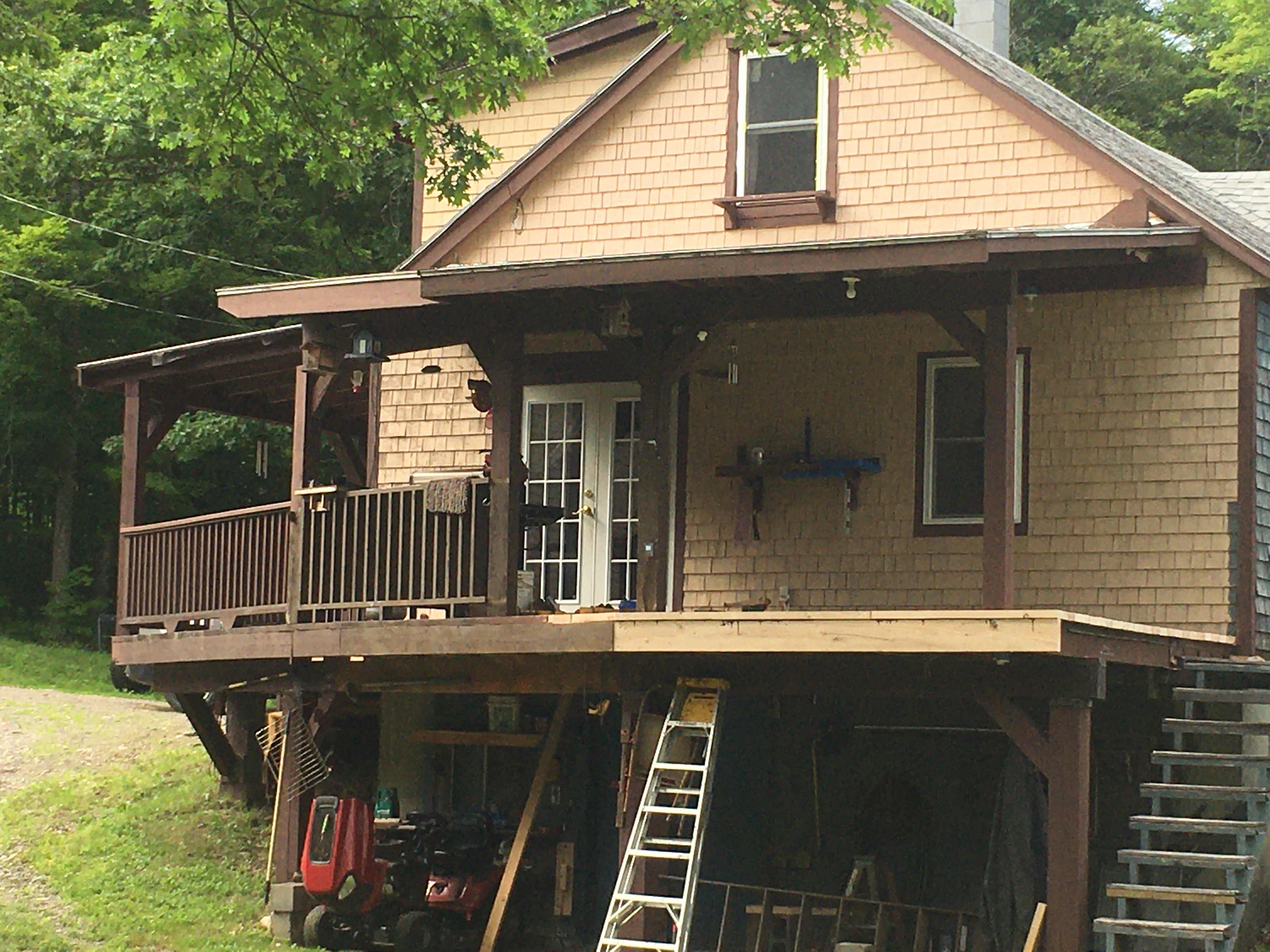

After two years in the making this rail section is done. The hard part was centering the 1-3/4" rail section in the 5-3/8"top hand rail and the bottom 3-1/2" rail part, due to the lack of math skills it required lots of pencil markings.......

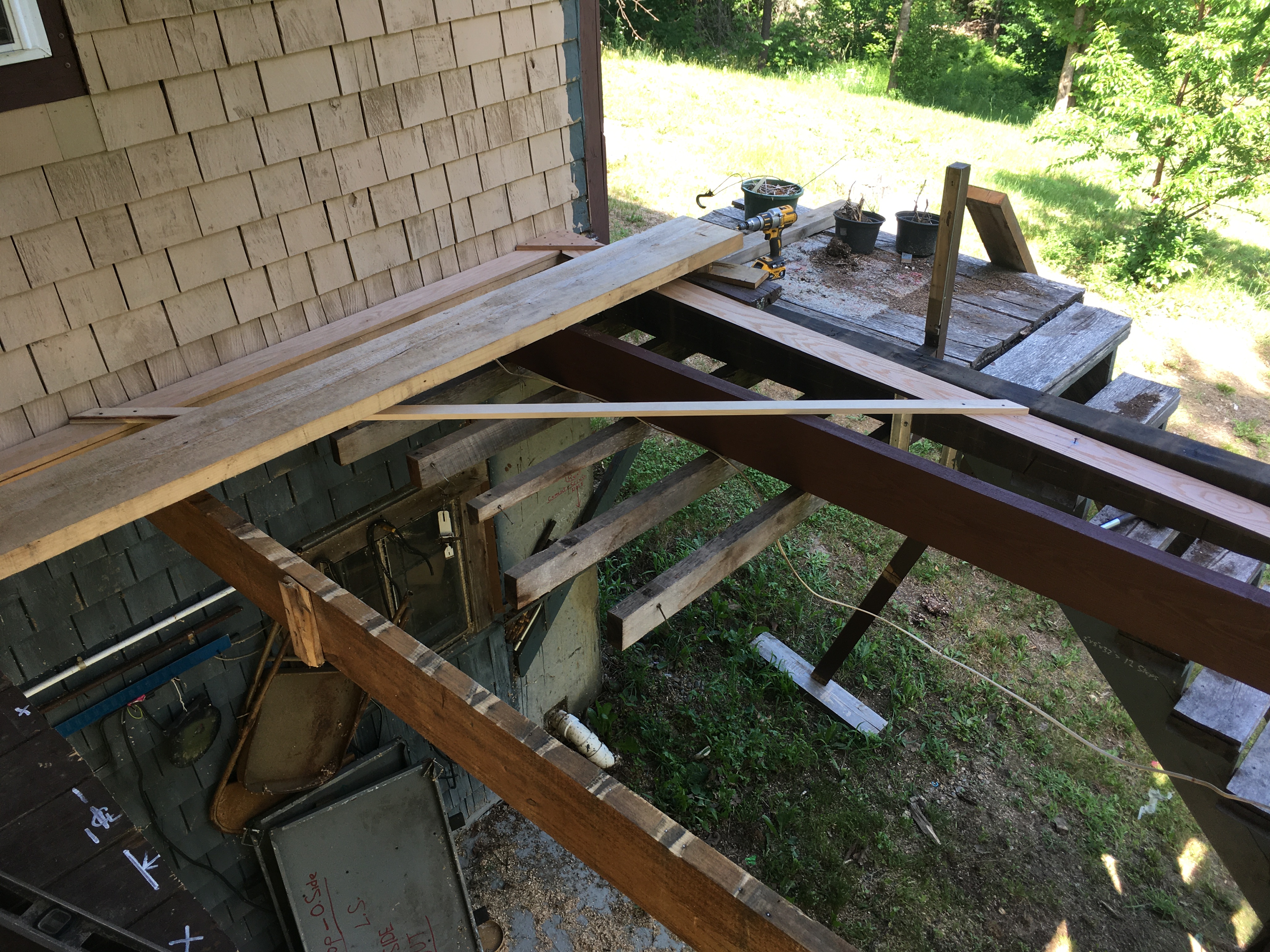

Made a start on deck repair, lessons learned so far is old deck screws dont like coming back out, saws-all metal cutting blades dont like cutting them either, I turned several blades blue, still have fare amount of screws that need dissecting so thinking of trying one of these carbide blades and see if that will do better.......

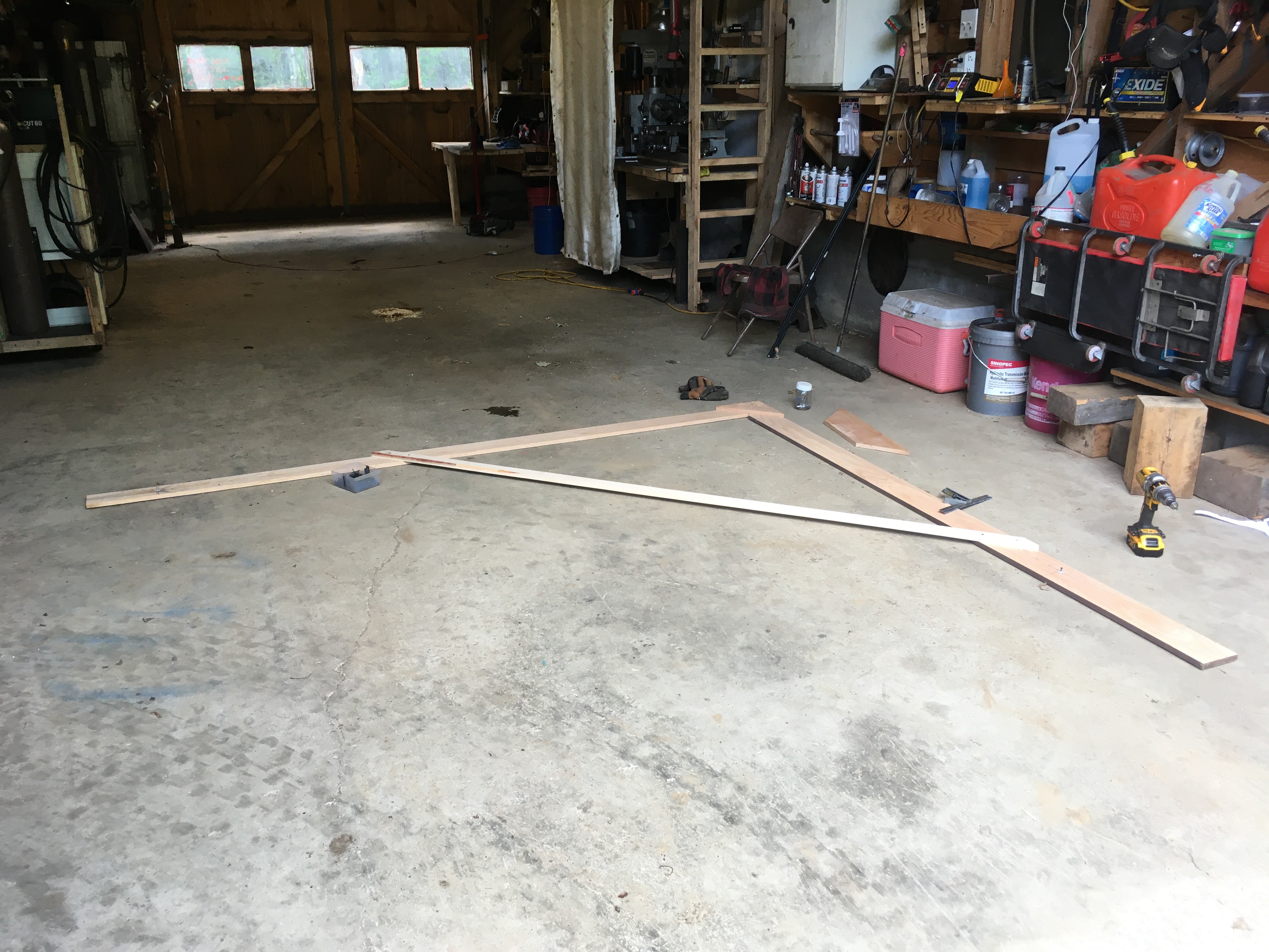

Sometimes a 2' square should be 10'.... So to keep floor joist straight and square I decided to make a 10' square just to get the first one right using 6-8-10, between that and a Bosch laser I'm close or close enough................
