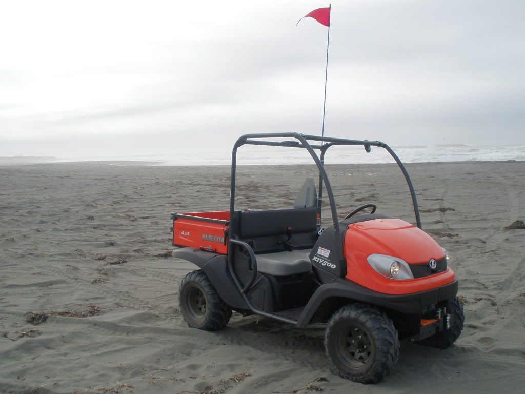

I needed just a little more room between the steering wheel and the back of the seat, so I had a piece of 1/2 plywood covered with some 1” thick padding and vinyl upholstery covering to replace the factory back bolster. I have found it to be much more comfortable than the thicker factory version. JH
I removed the factory seat and traced the size onto a 1/2" piece of plywood and then took it in to a local lady for covering, she used a color that matched kubota gray, you could use whatever looks best to you. I mounted it with the existing holes and lag screws. JH
that came out great it looks like it was put on at the factory.nice pic of the rtv on the beach too.where's that at ?gulf coast the sand kinda looks like what we got down here and around texas.
That is a great picture of the beach and kubota. The seat is a good idea, I wondered how a tall person had any room to move in regards to the dash/knee. Great job. bordercollie
