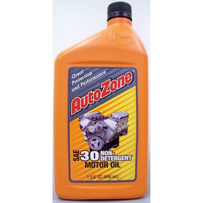

I have a 5 hp B&S I bought 30 years ago together with a water pump. It is seldom used, maybe 75 hours by now, so essentially new. I last used it about 1997.
I thought its owners manual back in the day specified 30 weight non-detergent oil. So today I bought a quart of 30 weight non-detergent, SAE grade SA. But reading its label, it says 'not recommended for automobiles made after 1930'. And that it is simply oil with NO additives.
Is this the right stuff for a 1980's B&S? Is there a later recommendation from B&S for that era of engine?

any mineral oil will work....they have not made non-detergent in many many years...u sure it is?
Its even hard to find 30 wt detergent oil today.
10w -30 w oil would work just as good.....do not use Synthetic oils in these older engines.

This really is non-detergent. I was surprised too when I read the container saying it has no additives at all and isn't suitable for much anything. Their web description doesn't mention the limitations.
The kid at Autozone was sure this is the right oil for garden equipment. But I'm going to take it back and get modern dino oil.

I would use the 30w you have in moderate to higher temps and 10w30 in lower (below 40) temps. I would think less of the specifics of the additives and more of the freshness of the oil, ie; no moisture, clean, etc...
Finally replacing my old explorer with 234k on 5k oil changes with whatever was cheapest. It still runs strong, though New England rust is taking it's toll.
There are always people who are fanatical about additives packages, and all that, I just feel correct weight for the temp, application and keeping it clean is by far the big deal.
