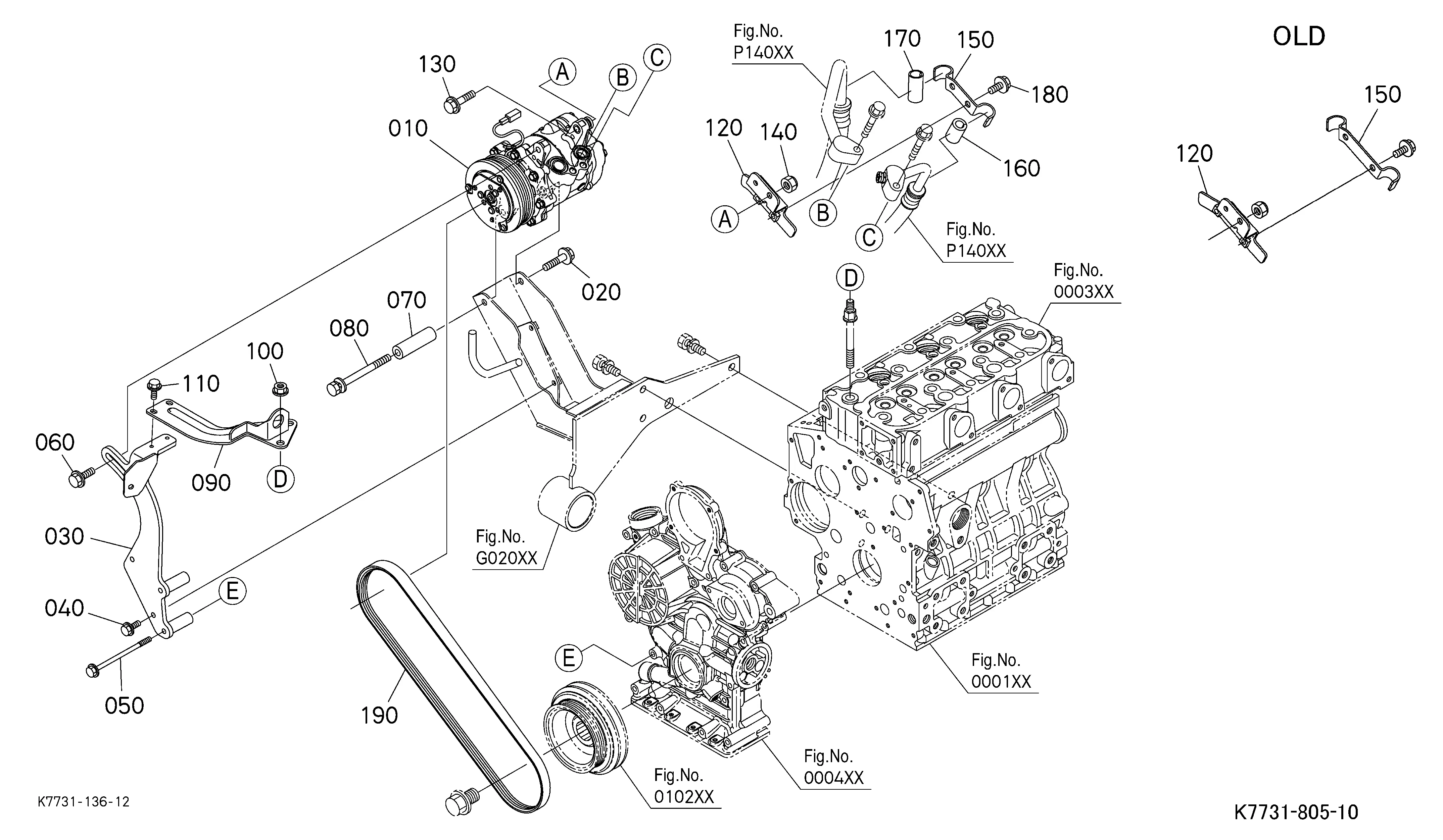

It appears you are asking me that question. I've not made the addition yet, so I don't know if it's absolutely necessary. However, if you go to post 16 of this thread, there are instructions posted by Armyaviatr, and the first step is to remove the wheel. I'm sure someone with experience will provide an answer. Based on the drawing, it appears that would make things much easier.
