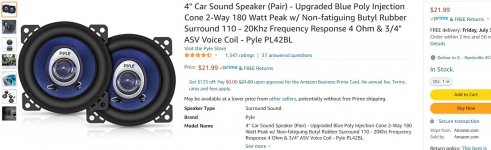

I went looking already at Amazon ...first think I found looks like it might work and is inexpensive IMHO.
That speaker looks awesome! The specs are great: 90W RMS AND 180W PEAK I think it has your 20w pretty well covered. And for that price you can hand em out as parting gifts. Reviews look good too!
My only concern is stuffing that big magnet in the mount. Next time I'll pull out a speaker and see if I can get a measurement to compare.
I agree. I took the chance and went ahead and ordered them. I can return them if they don't work out. Will post here either way.
:ROFLMAO: yeah my guesstimate of 20w seems Ludacris now. :bonk:
