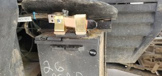

After reading several threads here about possible fires on RTVs - I elected to install a quick release main battery disconnect on my RTV900 in the event of the unthinkable. If a wiring short occurs you can quick and easily flip this arm on this unit to disconnect the battery neg terminal immediately and hopefully contain the damage. Installs in 5 min - just take off the cable on the negative post and put this in place. The negative cable now is installed in the adjacent post and makes contact with the copper lever. Got this at tractor supply for about $20.
Still would recommend carrying a fire extinguisher just in case!!

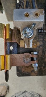

It was a nice warm day today, 42ºF and I went out to the outer shop and turned on the 13.5KW electric heater and tinkered on my RTV900 for a couple of hours. I was not totally happy with my battery cutoff that I put on the other day and so I redid it. When I took the negative battery cable off the other day, this is what it was like.....2 pieces that could never tighten down on the battery post. I cut the broken ends off and bolted it onto the disconnect. I also turned the disconnect around to get it completely under the battery cover. Much nicer and much cleaner.
Peter
